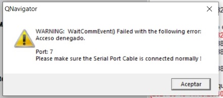

Many thanks! Apparently it must be a problem with the usb ports on my laptop, when I try a different one it works perfectly. Anyway, in case it helps anyone, this was the problem I was getting:
