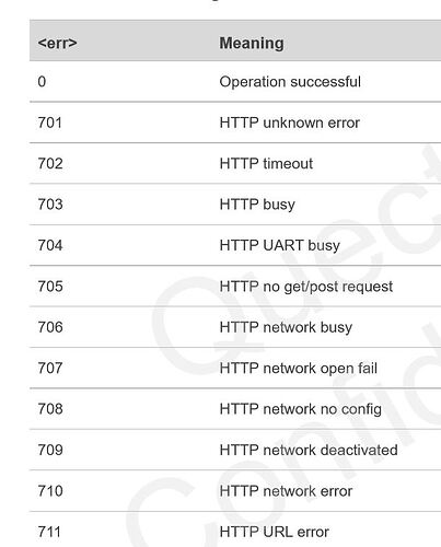

Hi Lennert,
Http error 701 means http connection fail ,
so ,pls check your network register status first .

Dear stephen,
I check all the network related command and it’s looking fine.
and 701 is not network error , it’s unknown error.

Tried on an EC21 we had to hand this morning, get different error (730), which means over the modems there’s a missing command or step somewhere which we’re not aware of. @Stephen.Li-Q Any pointers?
Dear shughes,
Error 730 Means you are not passing Certificate properly or your certificate is invalid ,
And also if you are passing certificate with uart then make sure you are adding \r\n after every line.
