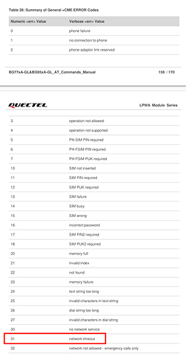

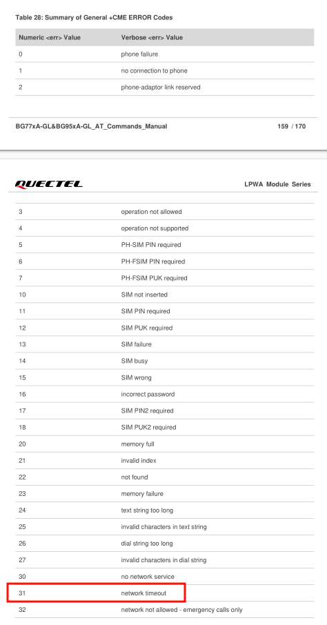

When sending the AT command AT+CGATT?, I sometimes receive the response:
+CME ERROR: 31
According to Quectel_BG77xA-GL & BG95xA-GL AT Commands Manual v1.1 , error code 31 means “Network timeout.”
What is the correct way to handle this error?
Is this a transient condition that should be handled by retrying the command?
Should the device wait and retry later?
Under what circumstances, if any, is a modem restart recommended?
I would like to understand the expected behavior of the BG950A-GL when this error occurs and the best practice for handling it in production firmware.
