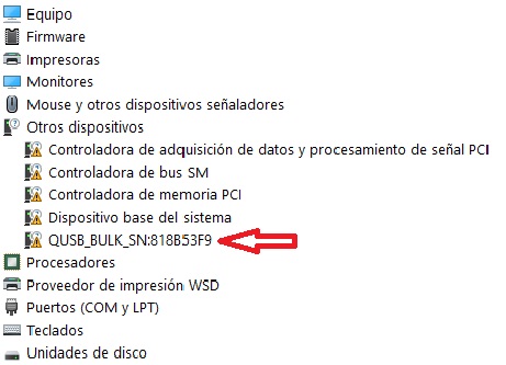

I HAVE ANOTHER MODULE THAT WHEN I CONNECT IT VIA USB APPEARS IN DEVICE MANAGER AS “QUSB_BULK”.
I LOADED THE FIRMWARE TO SEE IF THE PROBLEM WAS SOLVED BUT NO.
THE FIRMWARE WAS LOADED CORRECTLY, BUT AFTER CONNECTING IT NORMALLY VIA USB THE “MODEM PORT” DOES NOT APPEAR IN “DEVICE MANAGER”
THE DRIVERS ARE TESTED WITH OTHER BG95-M3 MODULES AND WORK WELL.
ANY SUGGESTIONS??
