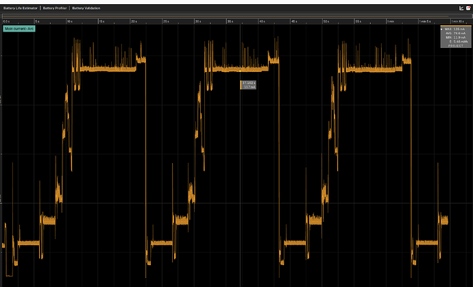

Power consumption of the whole board while the MCU is in sleep mode. There are no other chips consuming power

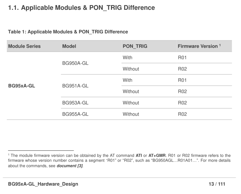

The firmware version of the modem: BG950AGLAAR02A01 which means it does not support PON_TRIG because of R02
It just seems like the modem reboots (see cycle in previous post)
