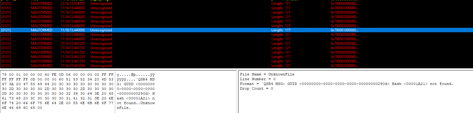

Hello, I am trying to debug messages from the BG95-S5 module using QXDM.
I recently downloaded the firmware, loaded the QSR4 file into QXDM, and attempted to observe the debug messages. However, many of the messages are recognized as MALFORMED messages.
Is there a separate QSR4 file specifically required for debugging these messages?
If there is an alternative method to perform debugging, could you please let me know?
Thank you.
Hi @northconnect
You can find the QSR4 file in firmware folder, and select lager size one.
