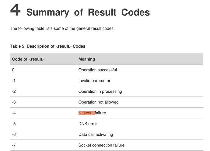

According to the Quectel_BG95&BG77&BG600L_Series_CoAP_Application_Note_V1.0 (Chapter 4: Summary of Result Codes), the return code -4 means “Network failure.”
My question:
What exactly does “Network failure” mean in this context?
Why would the same command succeed on the NUCLEO + EVB kit setup but fail with a -4 on my custom PCB?
