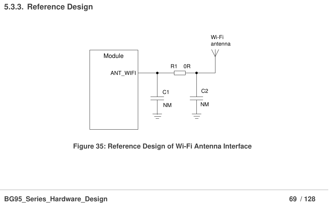

Is it possible to add this ceramic 2.4 GHz antenna directly to the Wi-Fi antenna interface (ANT_WIFI) on BG95-MF with a 6.8 nH inductor in series?
Or perhaps use this one by Quectel: https://www.quectel.com/product/yc0009aa-wifi-bt-smd-antenna/
The inductor and 2.4G ceramic antenna can be used as a whole antenna, and I think the 6.8nH inductor you mentioned is a matching component for the ceramic antenna.
