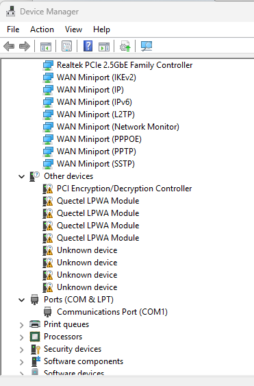

I’m having a bit of trouble with the drivers. I followed the instruction guide for downloading the Quectel Windows USB Driver(U) V1.2 driver. I did not work. I uninstalled them and reinstalled twice to see if maybe they did not install properly. I’m still getting the ‘Quectel LPWA Module’ yellow triangle. I even tried on a different computer and it still did not work. I’m using windows 11 if that helps. Any suggestions?
Hi @lunarstars
Please try with this one.
Quectel_LTE&5G_Windows_USB_Driver_V2.2.4.zip (9.6 MB)
