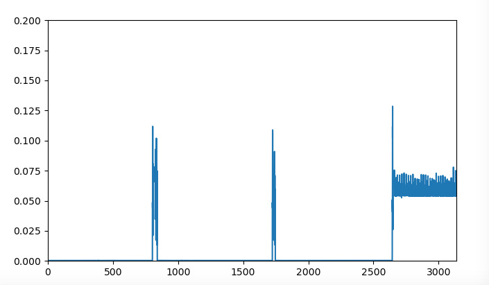

Instead of turning off the module, now we are using PSM mode and it worked fine for a longer time. But eventually it stoped responding to commands again. I attach a graph showing the current consumption. The horizontal axis is in seconds and the vertical axis is in Amperes. You can see at the end the moment where the module locks up and stops responding to commands, and keeps drawing around 60mA of current.

The interval between the two high pulses seems to be 900 seconds. Is this a keepalive?

The first two pulses that you see in the graph shows the system working as described in the previous list. But in the third measurement cycle, the BG95 locks up and stops responding to AT commands and keeps using about 60mA of current constantly. After a couple of minutes, the BG95 starts responding to AT commands again, but the problem is that the battery life is greatly reduced, because it keeps using 60mA whenever it locks up.
