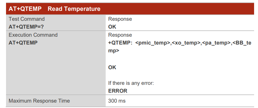

I have a question about AT+QTEMP. Changes were made to this command in the firmware “R02A04_01. 200.01.200”, but unfortunately the documentation was not updated.

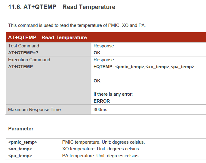

The “Quectel_BG95&BG77&BG600L_Series_AT_Commands_Manual_V2.0.pdf” documentation says the following about QTEMP:
The release notes for the firmware say:
Since this firmware, four values ​​are now output instead of three.

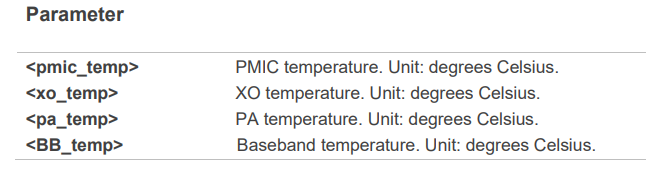

Which value is which after this change?
I am sorry about that and I will send you the latest manual.
