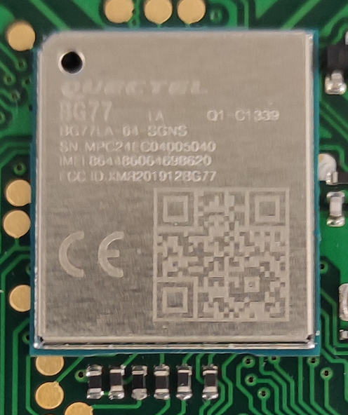

Could you please take a photo of the module? Much appreication
Not at this moment. I’m controlling it remotely and the device can’t be opened right now
Here you have the photo of the module in another device. We can assume they are both from the same batch. Let me know if this is useful
Shared the latest firmware version to you, you can flash and try. Much appreciation
