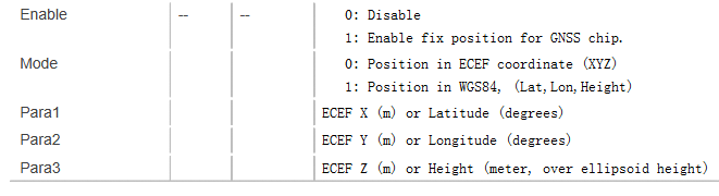

Once know the fixed location U can set the module in ecef or lat.lon.hei e.g.
$PAIR604,1,1,40.0018246,116.2122758,49.21*06
pair command list in mega_link.
Wow, Marco, what are these secret commands from the SimCom document?! They are not documented in the Quectel document…Seems like there is more to the LC29H than I realized…
