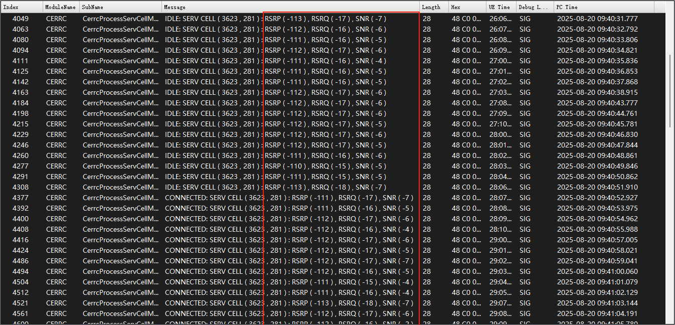

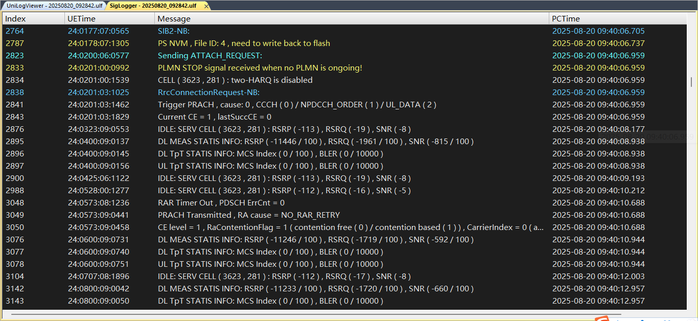

One of our devices using a BC660K has stopped working for unknown reason
Are you able to tell me anything from the attached log?

The signal detected by the UE is extremely weak, with relatively low RSRP and SINR values. Please try moving to a different location or getting closer to the base station.
Or you might need to check the RF and the antenna.
