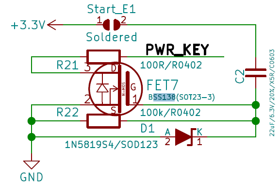

Thankyou for your response. I am using development kit, it has following circuit on BOOT pin - 7 of the module.
Here PWR_KEY is the net connected to BOOT pin of the module. This is only delaying the initial startup by around 1.5s. But my module boots up after around 30s.

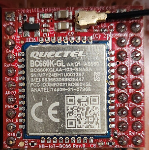

Is the module BC66NB or BC660K-GL? Because these two have different handling or PWRKEY/BOOT pin. With BC660K-GL you normally don’t use this pin. Is Start_E1 closed/soldered or open?
This is BC660K-GL. Here is the image of module.
S

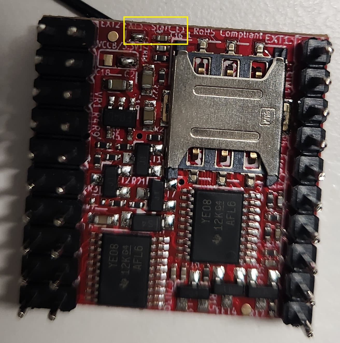

You have Rev D and the latest schematics seems to be Rev B. Could you post a picture of relevant part of the PCB bottom? The Start_E1 may be soldered/closed, while you want it open.
Here is bottom side of PCB. I can see Start_E1 as soldered (short). Should I open it (desolder) and try?
Yes, desoldering should help.
