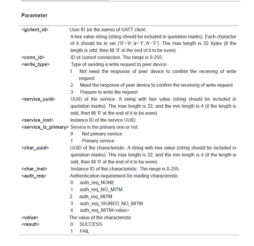

Hello team, I have a problem when trying to write a value to a characteristic.
When I send value with 24 symbols - the write is OK, but when I send a value with 48 symbols it returns FAIL.
Any limits in the length?
Hi
Yes, please refer to our ble documentation for details
