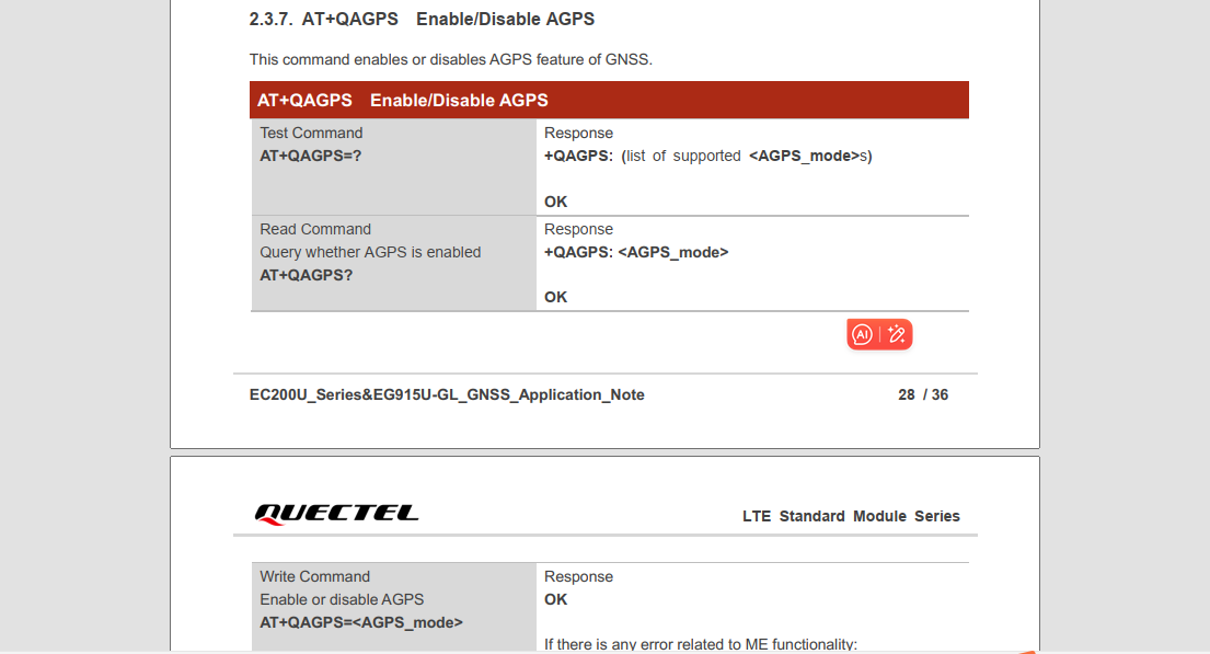

Hi,
Is it possible to enable assisted gps on EC200U-CN module to improve the fix time. I’m using quecpython for our development.
regards,
Please check whether AGPS is already included in example of EC200U for Quecpython
Hi,
This is the response I got, when I ran that at command in quecpython:
Please provide your current firmware version
AT+QGMR
Current firmware version:
It does not support EC200U
The version of Quecpy might be too old. You may need to update to the latest firmware version, but Quecpy does not support the latest firmware version
The quecpython version I’m using is v0003, I see there is a new version called v0004, but v0004 does not have a .pac file, there is only a .bin file. I’m not being able to flash this bin file using qflash.
On another support ticket I saw one of your support engineer saying that AGPS is enabled by default in quecpython. This is that ticket Request for support how to do APGS server settings in Quecpython in EC200U module
