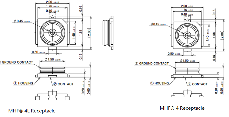

we bought a EM05EFA-512-SGAS M.2 module. We are wondering about the antenna connector, is it a MHF or IPEX 4 or 4L?

P.S
  • MHF 4 is suitable for use with 0.81 mmø cable
  • MHF 4L is suitable for use with 1.13 mmø cable
    Both mates with MHF 4 and MHF 4L receptacles…
