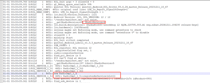

RadxaRock5C:/ # logcat | grep -i ril
01-01 00:00:09.040   457   457 F linker  : CANNOT LINK EXECUTABLE "/vendor/bin/hw/rild": library "android.hardware.radio@1.2.so" not found: needed by /vendor/lib64/libril.so in namespace (default)
01-01 00:00:18.666     1     1 I init    : starting service 'ril-daemon'...
01-01 00:00:13.401   634   634 F linker  : CANNOT LINK EXECUTABLE "/vendor/bin/hw/rild": library "android.hardware.radio@1.2.so" not found: needed by /vendor/lib64/libril.so in namespace (default)
01-01 00:00:18.680     1     1 I init    : Service 'ril-daemon' (pid 634) exited with status 1
01-01 00:00:18.680     1     1 I init    : Sending signal 9 to service 'ril-daemon' (pid 634) process group...
01-01 00:00:23.668     1     1 I init    : starting service 'ril-daemon'...

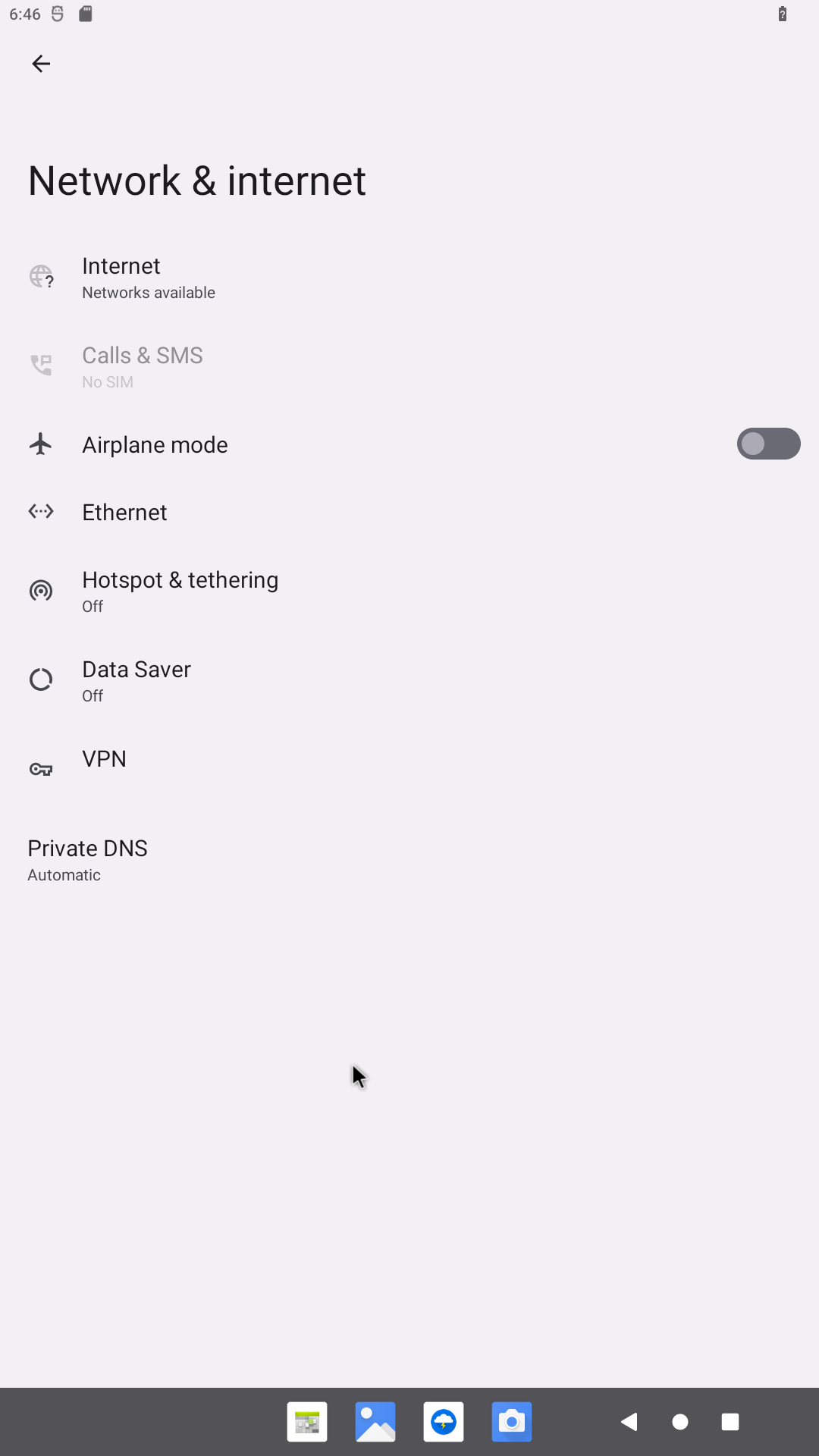

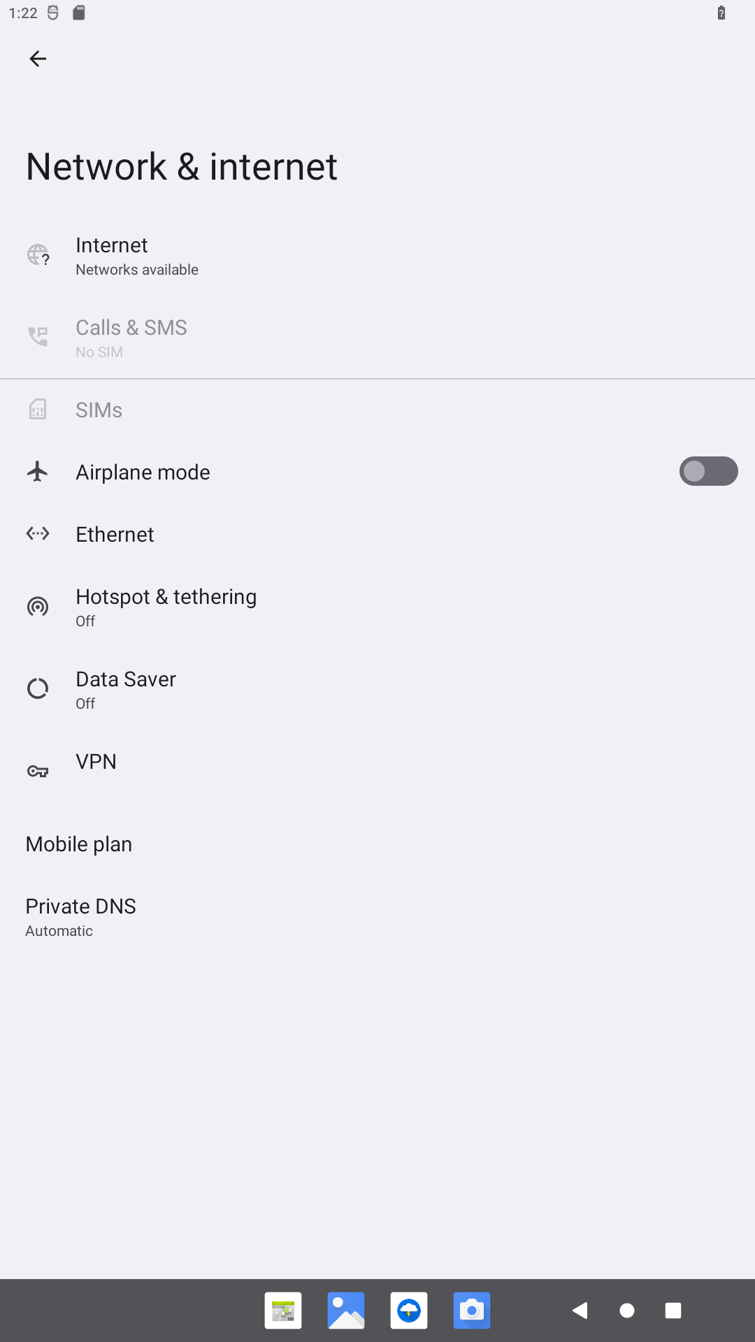

we don’t have a Mobile data option in android settings and how to enable mobile data option

I have enable mobile data in config.xml but we can’t able to proceed next step
true

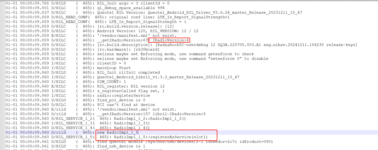

IRadio 1.5 or IRadio 1.4?
Which one you set in the manifest.xml and which libril.so you tried?
we are using radio1.5
