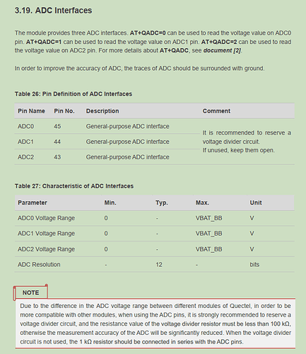

Is there a way we can take analog inputs in the EC200U using ADC pins if so how do we utilise them
I have quectel EC200U alongwith the UMTS and LTE EVB kit V2.2
Hi @drath
You can refer to this:
Hi @drath
