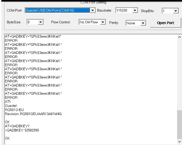

I am very sorry to disturb you. I would like to open the ADB port of the RG501-EU,
current version: RG501QEUAAR13A01M4G
+QADBKEY:52582990
thank you very much!

@Niki.Liu-Q It reports an error, it seems that the password is wrong?
hello,I regenerated the password and it is the same, @silvia hi Silvia, could you help to check this issue? thanks~
@Niki.Liu-Q How do I check?
Dear @US_michael
Please check the characters are in English.
If show error, it means the password is wrong, type or others.
That’s right, I’m using the English state,
and I was able to turn it on successfully by lowering the R12 version!
R13 will report an error? Seems to be a version issue?
Dear @US_michael
It is recommended to use R12 baseline.
