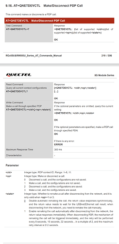

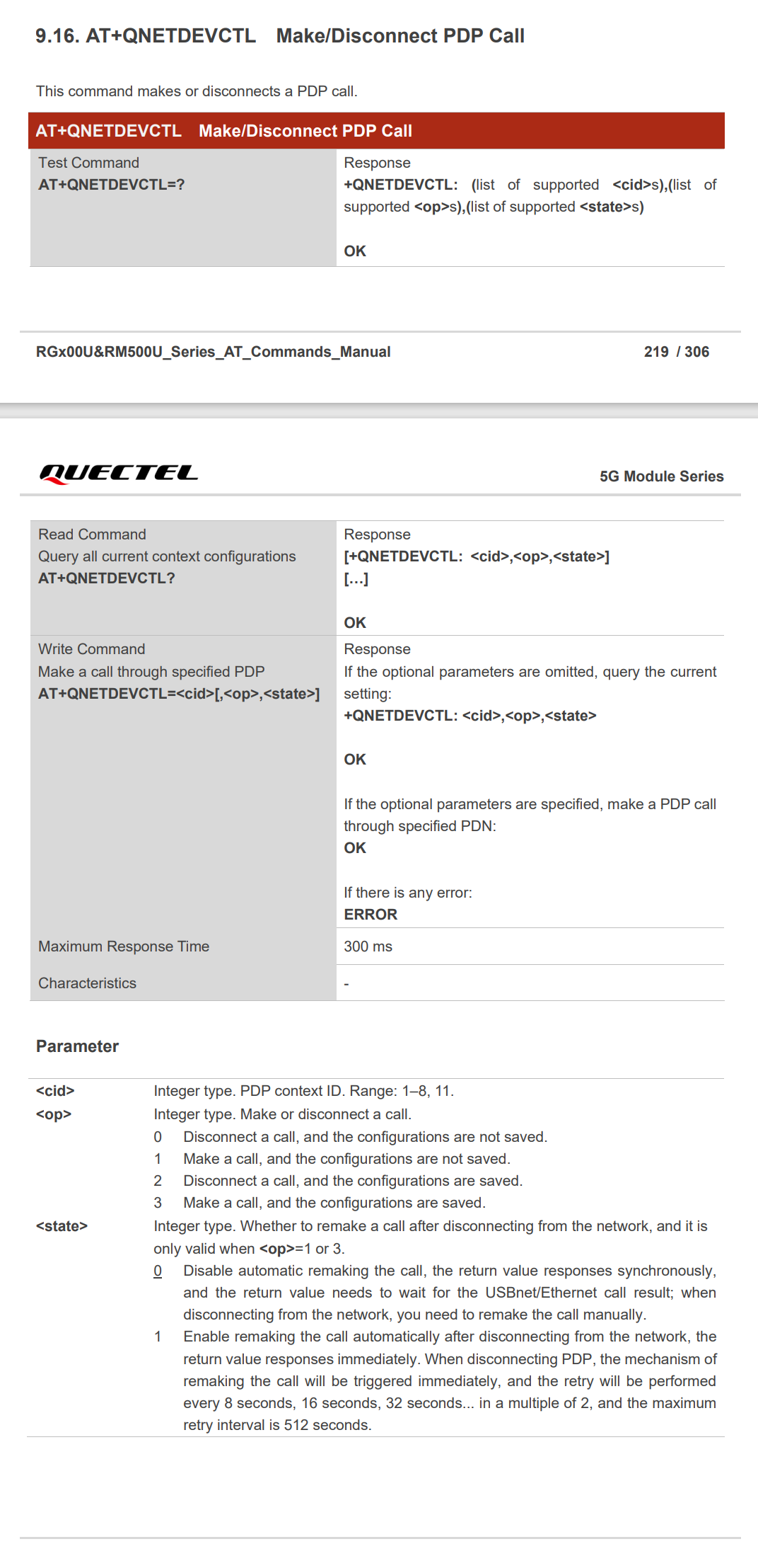

Dear @TR_J
You can try to mark a data call via AT+QNETDEVCTL, like
