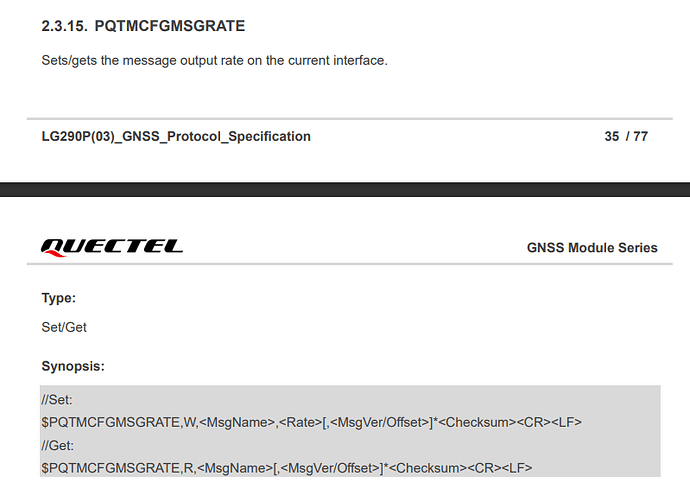

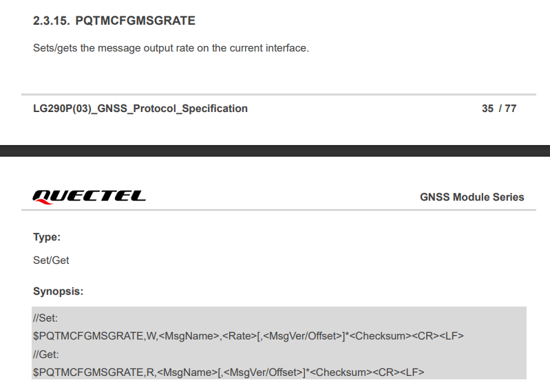

Hi Kt3351,
QGNSS tool is a serial port tool for Quectel GNSS module using on Windows system. You can download QGNSS tool for firmware upgrading and debugging on Quectel modules. Download link:
If you want to change some NMEA data output, please refer to PQTMCFGMSGRATE command.
Please pay attention to “MsgVer” message version parameter. You will find this parameter in the synopsis of specific PQTM message.
