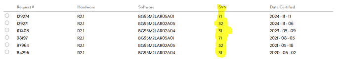

What AT command (or where can I find) the SVN for the BG95M2 module I am using? I’m trying to get end-device certification for PTCRB and they are asking for an SVN. The options seem to be 71 or 32.
When I query with ATI on my modem I get the following information, but none of this looks like the SVN.
BG95M2LAR02A04_01.009.01.009
Quectel
BG95-M2
Revision: BG95M2LAR02A04
Thanks!

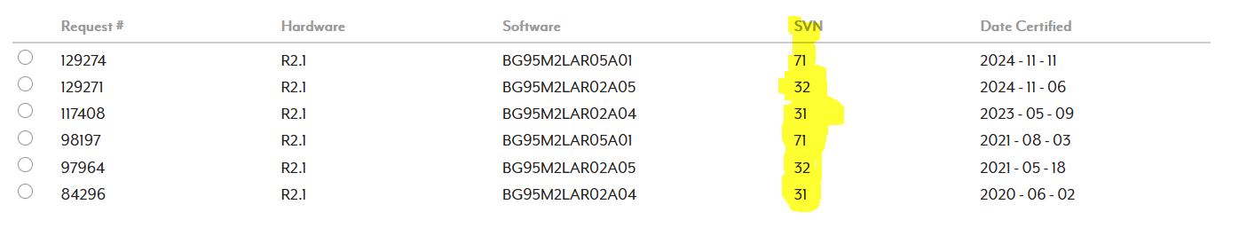

The SVN of BG95M2LAR02A04 is 31.
