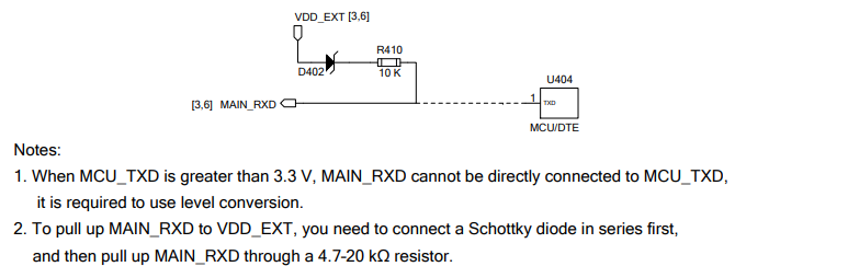

Hello,
In the Reference Design Guide of the BC660K-GL could someone explain what is the purpose of the diode ?
If the MCU is 3.3V is this still needed?
Thanks
Regards
Reply:Prevent leakage current.

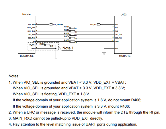

Reply:yes,Need to set the uart port of BC660K voltage domain to 3.3V,The voltage domain settings are as follows:
