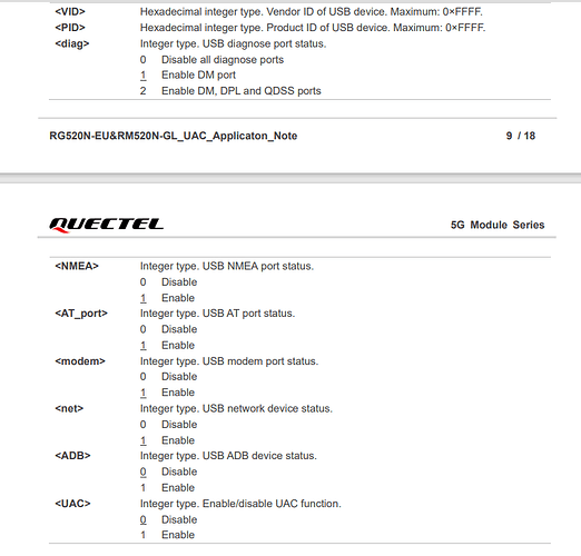

What document for: AT+QCFG="usbcfg"
What document are the AT commands for
AT+QCFG=“usbcfg” covered in for the RM520N-GL
Hi, Sir
you may take following screenshots as reference
