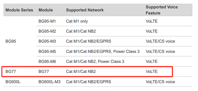

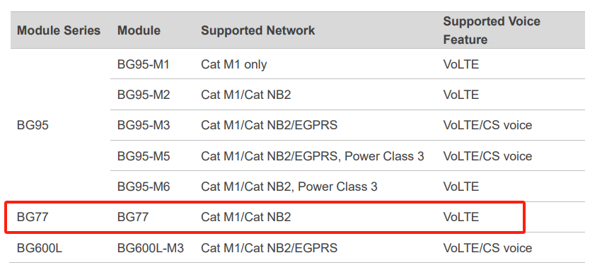

BG77 Series are support VoLTE and I will send you this application note via email.

Hi Dominique,
The BG77 normal version will support VoLTE.
