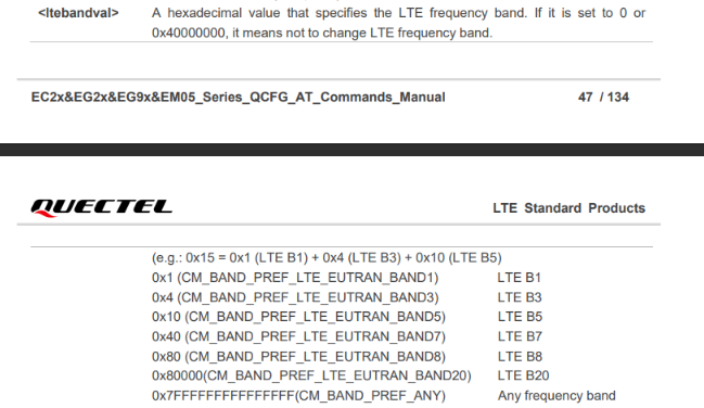

No. Correct bandmask is 0x80045.

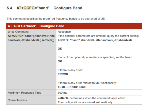

Yes, the correct please use Band 0x80045.
You may refer as below sceeshot of the command:
