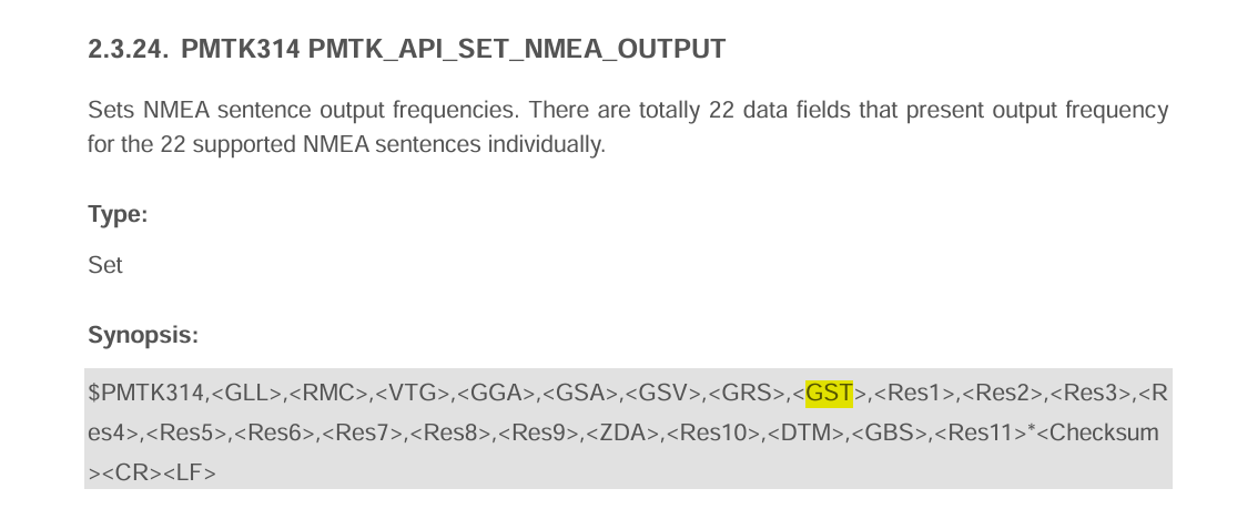

Hi santosh
The (GST) message default is not output, you should use command($PMTK314,0,1,1,1,1,1,1,1,0,0,0,0,0,0,0,0,0,0,0,0,0,0*35) to open it. About more information, please refer Lx6&LC86L&LG77L Series GNSS Protocol Specification. I have sent relative technology document through email, please check it.
