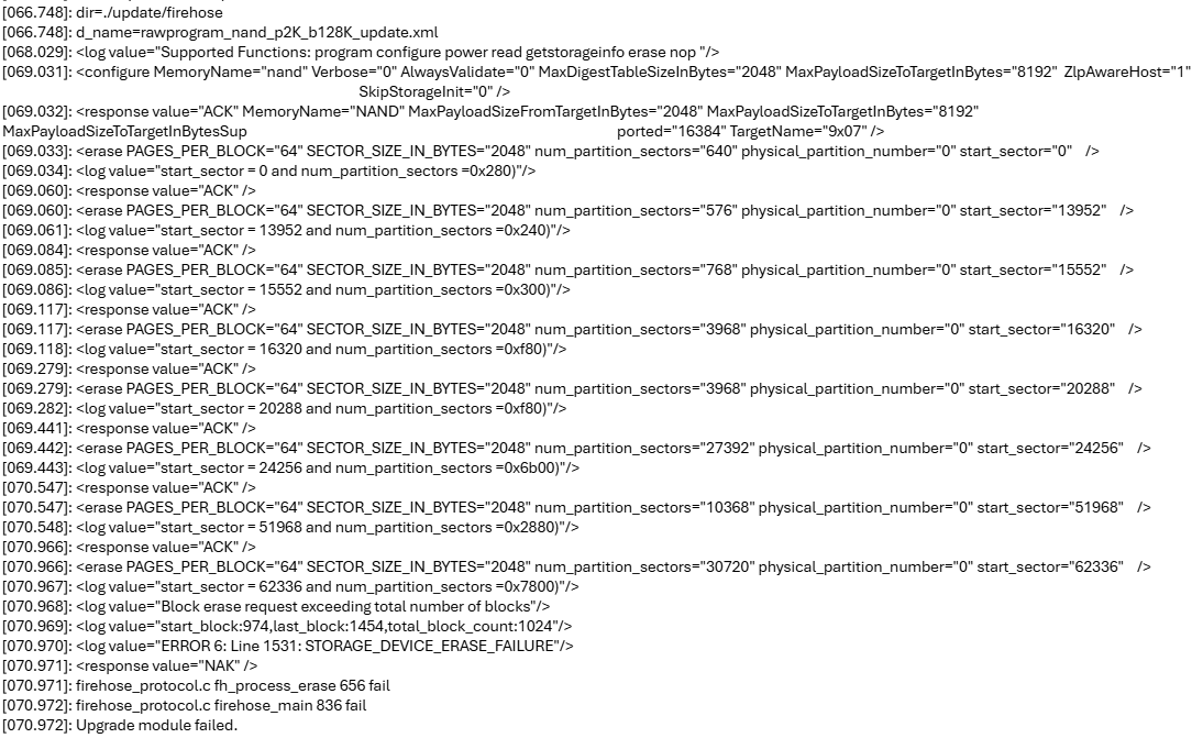

Hi I have a EG25-GC with 30.001.30.001 and are trying to upgrade to 30.201.30.201 with QFirehose v1.4.5.3. Unfortunately i fails with the log below.
I could recover it by applyiing 30.001.30.001 again. Is it a QFirehose issue or something else?
[067.239]: STATE ← SAHARA_WAIT_COMMAND
[067.240]: RECEIVED ← SAHARA_READ_DATA_ID
[067.240]: 0x0000000d 0x0001e000 0x00001000
[067.241]: STATE ← SAHARA_WAIT_COMMAND
[067.243]: RECEIVED ← SAHARA_READ_DATA_ID
[067.244]: 0x0000000d 0x0001f000 0x00001000
[067.247]: STATE ← SAHARA_WAIT_COMMAND
[067.248]: RECEIVED ← SAHARA_READ_DATA_ID
[067.248]: 0x0000000d 0x00020000 0x00000658
[067.252]: STATE ← SAHARA_WAIT_COMMAND
[067.275]: RECEIVED ← SAHARA_END_IMAGE_TX_ID
[067.276]: image_id = 13, status = 0
[067.276]: SENDING → SAHARA_DONE
[067.276]: STATE ← SAHARA_WAIT_DONE_RESP
[067.276]: RECEIVED ← SAHARA_DONE_RESP_ID
[067.276]: image_tx_status = 0
[067.276]: Sahara protocol completed
[067.277]: dir=./update/firehose
[067.277]: d_name=rawprogram_nand_p2K_b128K_update.xml
[068.559]:
[069.560]:
[069.562]:
[069.562]: firehose_protocol.c fh_send_cmd 531 fail
[069.563]:
[069.565]:
[069.571]: firehose_protocol.c fh_send_cmd 531 fail
[069.591]:
[069.591]:
[069.592]:
[069.616]:
[069.616]:
[069.617]:
[069.648]:
[069.648]:
[069.649]:
[069.809]:
[069.810]:
[069.810]:
[069.971]:
[069.971]:
[069.972]:
[071.076]:
[071.076]:
[071.077]:
[071.495]:
[071.496]:
[071.496]:
[071.497]:
[071.498]:
[071.499]:
[071.499]:
[071.500]: firehose_protocol.c fh_process_erase 656 fail
[071.501]: firehose_protocol.c firehose_main 836 fail
[071.501]: Upgrade module failed.
Adding a screenshot instead as paste didn’t work correctly
