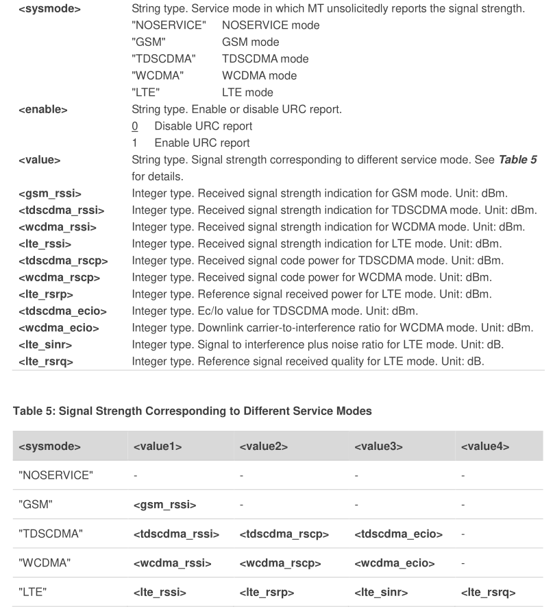

Hi there,
The unit of SINR is dB. The SINR value printed by the module is 157. It needs to be converted.
img_v3_02122_affc3bdd-a457-4e6a-8308-537e31adc9cg

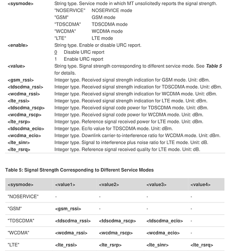

Hi ,
You can find the document named Quectel_EC2x&EG9x&EM05_QuecCell_AT_Commands_Manual_V1.0
