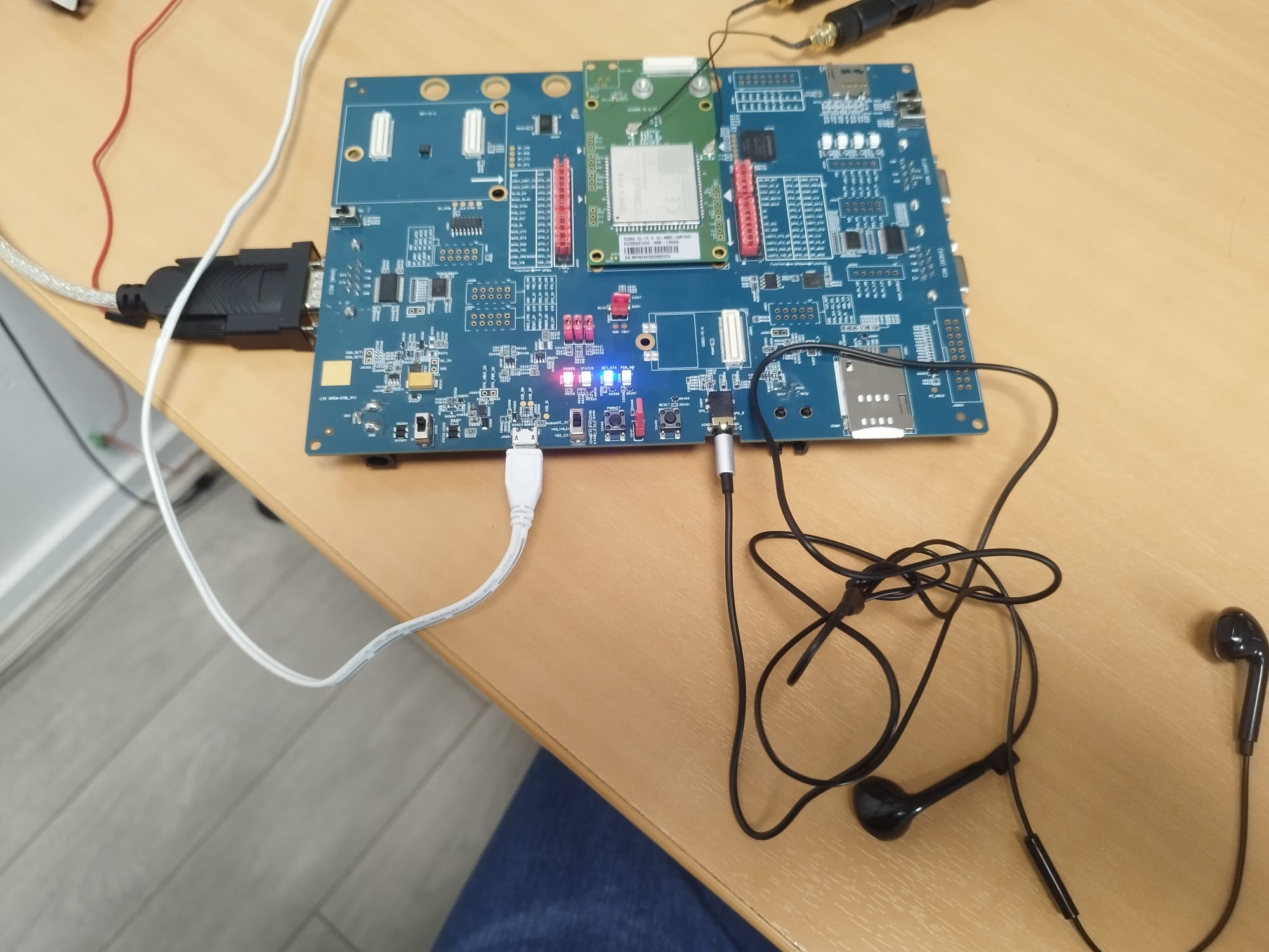

I use :
  • LTE-OPEN-EVB-KIT
  • EC200AEUHA-N06-TA0AA
with :
AT+QGMR
EC200AEUHAR01A24M16_01.200.01.200
commande AT :
AT+QFTPGET="test.amr","UFS:test.amr"
OK
+QFTPGET: 0,26886
AT+QFLST="UFS:*"
+QFLST: "UFS:test.txt",1022418
+QFLST: "UFS:test_file.txt",0
+QFLST: "UFS:test.amr",26886
OKAT+QFTPGET="test.amr","UFS:test.amr"
OK
AT+QAUDPLAY="test.amr",0
OK
(wait 20s)
+QAUDPLAY: 0
AT+QTTS=2,"hello world"
OK
(wait 3s)
+QTTS: 0
but I have never soud in my earphone
The EC200AEUHA is using the PM802 and it do not support internal CodeC.
So you need an external CodeC.
HI,
Where can I buy this external codec module ?
If you have bought the Quectel EVB, it should include the CodeC module.
