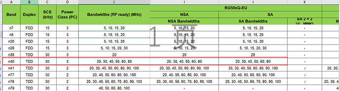

I am working with the Quectel RG501Q‑EU in a private 5G SA deployment on band n40, and I’m trying to verify the exact NR channel bandwidths and Subcarrier Spacings (SCS) that the module supports in FR1. In particular, since our network configuration relies on relatively narrow carriers, I need to confirm whether the RG501Q‑EU can operate with a 10 MHz NR channel bandwidth using an SCS of 30 kHz on band n40 in SA mode. This specific combination is essential for us to validate compatibility before finalizing the radio parameters.
More generally, I would like to clarify which FR1 bandwidth options (5/10/15/20/… MHz) and which SCS values (15/30/60 kHz) are actually supported by the module in SA operation, and whether any of these combinations are restricted by band, modem configuration, or firmware.
If possible, could you provide the official list of supported NR bandwidth and SCS configurations for the RG501Q‑EU, or confirm the validity of the 10 MHz @ 30 kHz SCS setup specifically on band n40?
Thanks!

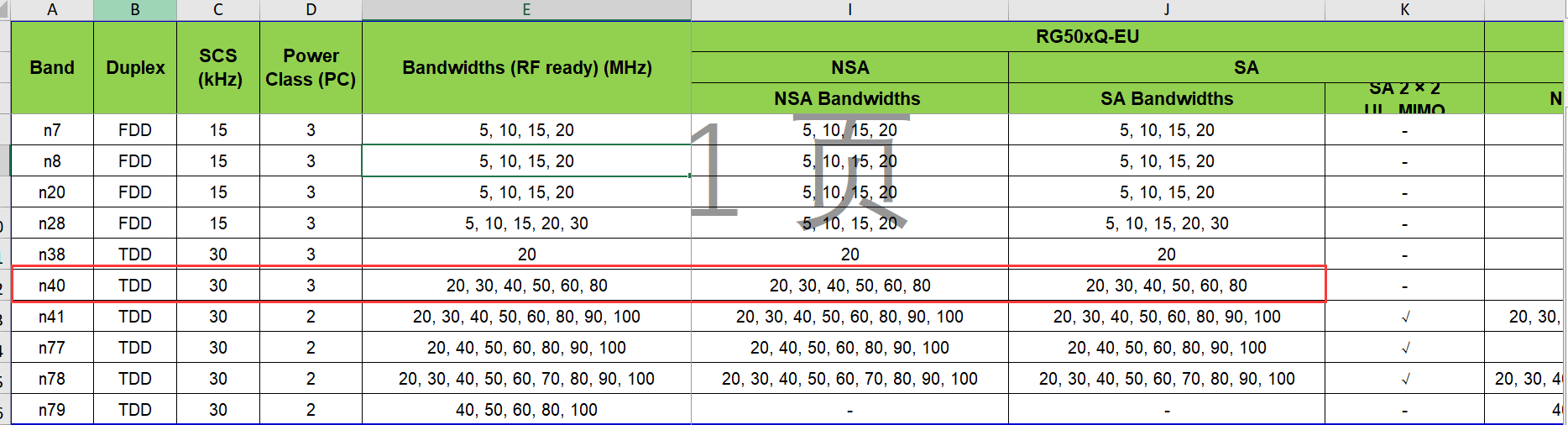

Dear @palfaro
Please check the picture as below:
Thanks for the quick response
