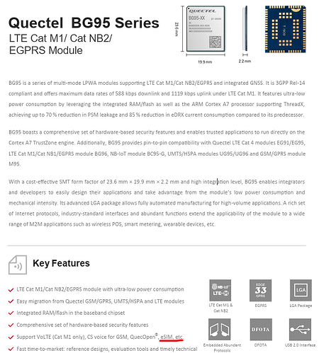

Hi,
Based on my review of the datasheet, this module doesn’t have an eSim feature. This feature appears on the BG95-M3 model.
Dear @Inventor_TM,
Thank You for reaching out to us.
As for EG912UGLAA, it does not supports on esim but you may add external eSIM chip and connect to the pins of USIM of the EG912UGLAA module.
Thank You and Have a Great Day Ahead!
Thank you Alvin for your reply
We proceed with the external eSIM
