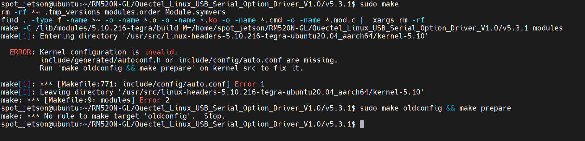

Moreover when I try to compile USB serial option driver then I am getting following error:
Regards,l

For the WWAN driver, please make sure that the Gobinet driver is not installed in your Linux system, because only one of these two drivers can be installed at a time. For the USB driver, you can first configure the kernel according to the steps in the guidance document (in the compressed package), or try the commands suggested under the path of the kernel source code according to the error message.
