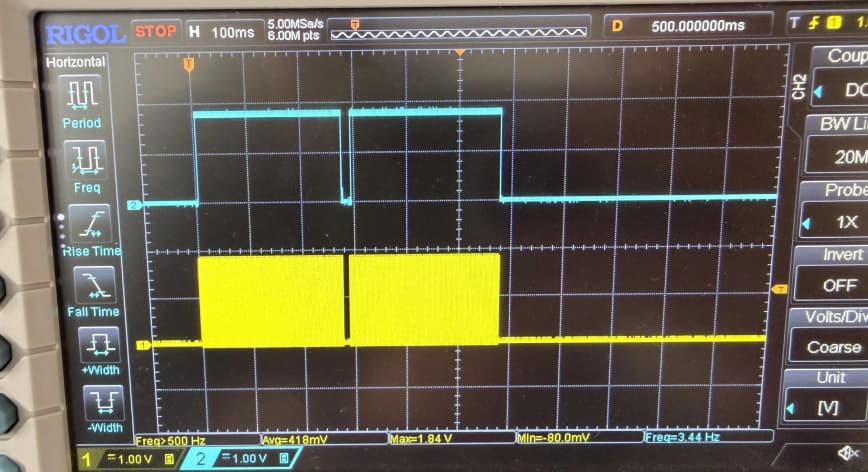

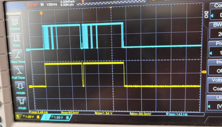

Please monitor whether the electrical characteristics of the sim_vdd and sim_data pins meet the design requirements.
Hi Herbert, we checked the characteristics.
on picture 1 is sim_vdd (yellow) and sim_data (blue)
on picture 2 is clock (yellow) and reset (blue)
The sim cards can not be recovered, if they fail once. Did you encountered any similar problem? Any Idea, how this can happen?
