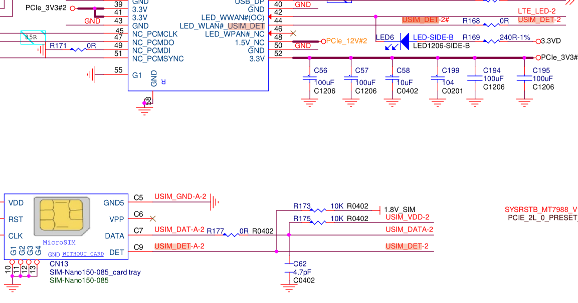

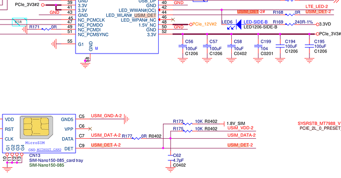

We use a Banana Pi BPI-R4 board and the SIM card detection pins on the mPCIe and M.2 B-key slots are wired.
Please advise if it’s EP06-E and EC25-E that don’t support SIM card detection. If that’s the case, please let us know of LTE-A modems with mPCIe form factor that do support it.
mPCIE slot:
M.2 B-key slot:

No thanks to Quectel support, after investigating the hardware design document for EP06, we’ve realised that EP06 does not include a SIM card detection pin. EC25 does have it and we made it work. And there is no Quectel LTE-A modem with mPCIe form factor that includes a detection pin at the moment.
