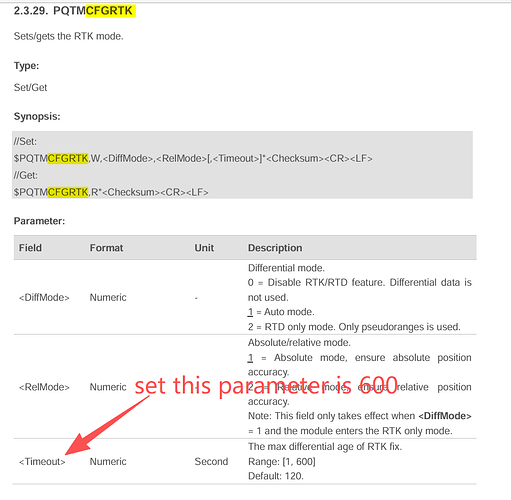

How do I set RTKHOLD on an LG290P with firmware v06?

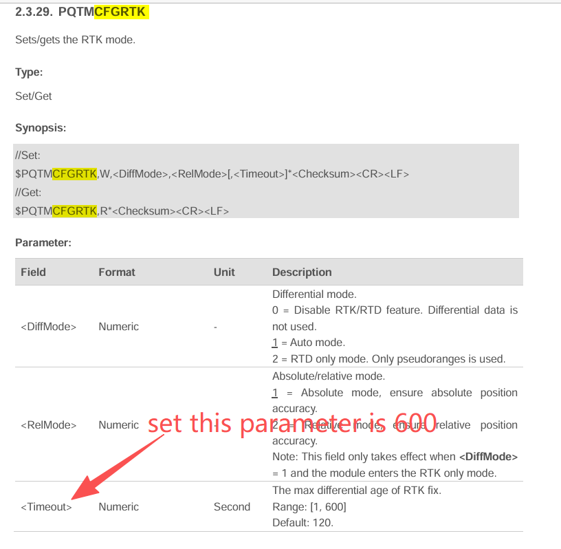

Please refer protocol specification, through this command($PQTMCFGRTK,W,1,1,600*76) to set timeout parameter is 600. And I have sent the technology document to you through email, please check it.
