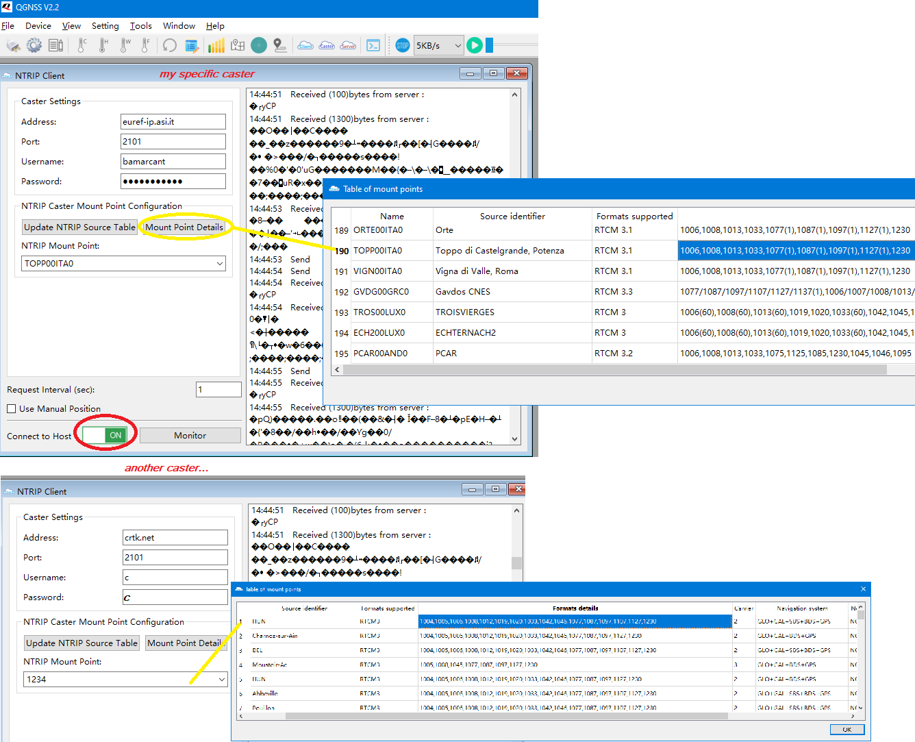

ok , considering gps 3d fix , cannot see pic;
need to exam ntrip…not only 1005 but at least 10x7 or 10x4 msm etc…given by the host.
So try centipede as a joke with c and c credenzial and watch if rtk float happen…

and in any case, to dispel any doubts, you should try the alternatives. As an example, I suggested Centipede, which transmits from private user stations with excellent instrumentation (usually Ubx FP9), so you can get a clue as to how to resolve it.
