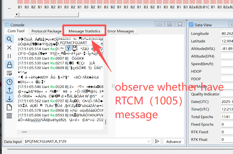

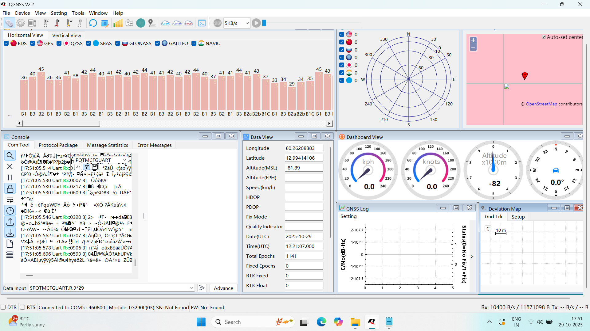

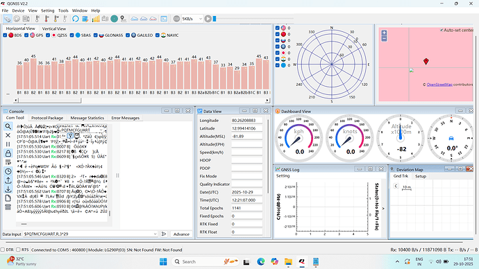

How do we tell if the base station has acheived RTK fix in survey-in mode ?
Attached is a screenshot from QGNSS. How do i tell if fix has been acheived and valid corrections are being sent to the rovers ?
Hi Srinath
Q:How do we tell if the base station has acheived RTK fix in survey-in mode ?
A: Please refer protocol specification
Through command as follows to enable this message output.
1).sent $PQTMCFGMSGRATE,W,PQTMSVINSTATUS,1,158
$PQTMSAVEPAR
5A
After reset module. This message will output.

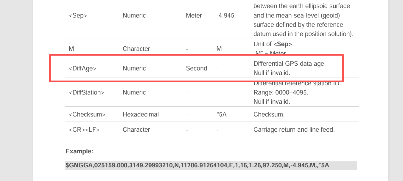

Q: How do i tell if fix has been acheived and valid corrections are being sent to the rovers ?step1:
step2: Then observe of GGA of rover.
If rover receive corrections, this will be less than 5s.
