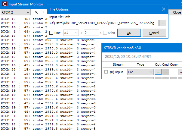

Please provide me the NTRIP_Server log file, it is in the LogFile directory with the NMEA Log

Rtcm sono del tipo 2 , non vanno bene;bisogna cercare un ntrip caster in rtcm3 msm4 o 7…

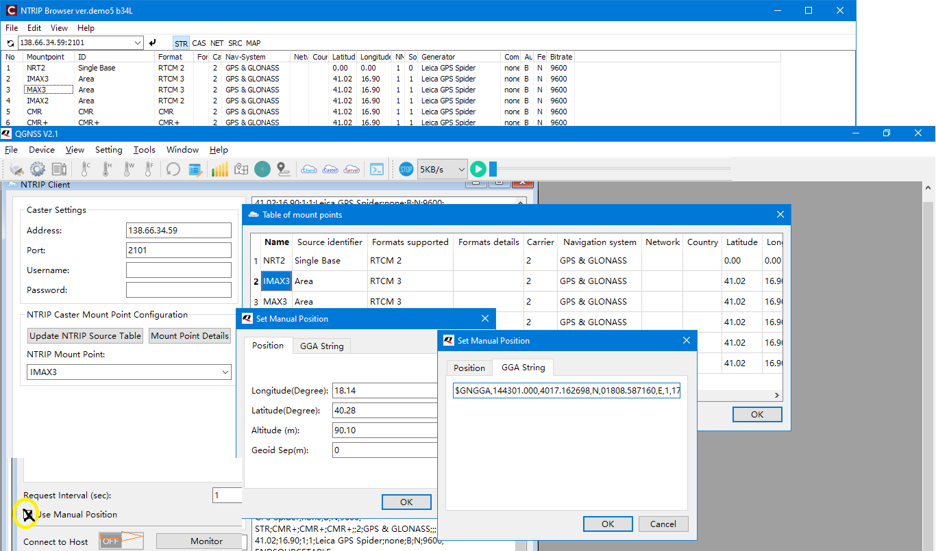

Per connetterti a Salice S. devi cliccare su “use manual position” e inserire le coordinate in position oppure la stringa completa della GGA,ovviamente usare IMAX3 oppure MAX3 che sono in rtcm3…e che offrono la stazione in base alla posizione (se inviata);altrimenti usa Bari di default o peggio va in nrt2.
Se connetti il modulo a un esp o radio_ble_wifi, puoi usare la app Lefebure e provare senza pc.

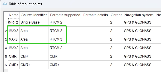

Hi @Emanuele_B
LC29HDA only supports RTCM version 3
20251210-113608
Can you try re-select the mountpoint that is RTCM 3 as drawn in the image below
Let me know if this help you obtain RTCM input
Best regards
Hello,
thank you for your clarification regarding RTCM version support.
I confirm that I have already tested RTCM3 mountpoints (IMAX3 / MAX3), however the issue persists.
With NTRIP connected and data received, I verified in QGNSS v2.2:
View → Raw Data
Filter applied: D3 (RTCM3 frame identifier)
The Raw Data window remains completely empty, which confirms that no RTCM3 frames are received or parsed by the firmware, regardless of mountpoint selection.

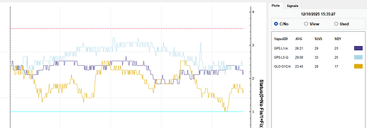

Hi @Emanuele_B
I found that the signal strength for both GPS and GLONASS are weaker as shown in the image.
It is generally recommended to be greater than 30 dB-Hz for signal strength, especially for both GPS and GLONASS
Can i know the placement of your GNSS antenna? How do you conduct your field test?
best regards

Hello,
thank you for your feedback regarding signal strength and antenna placement.
I understand that higher C/N0 (>30 dB-Hz) is recommended for stable RTK convergence.
However, my current issue occurs before the RTK solution stage.
Specifically:
  • With NTRIP connected and IMAX3 (RTCM3) selected
  • GGA is sent correctly
  • In QGNSS v2.2, Raw Data filtered for D3 remains completely empty
  • No RTCM3 frames are received or parsed by the firmware
  • RTK status stays in GPS SPS Mode, RTK Float/Fixed = 0
Since RTCM reception is a pure input/parsing function, it is independent of GNSS signal strength, antenna placement, or sky view.
Even with low C/N0 or indoor conditions, raw RTCM3 frames should still appear in Raw Data if the firmware supports RTCM input.
Therefore, the current behavior strongly indicates that the firmware
LC29HDARAN11A03S_RSA does not have RTCM/RTK functionality enabled for LC29HDAMD (Q1-C0634).
For completeness:
  • Antenna: GNSS active antenna mounted outdoors with clear sky view
  • Field test: static test, open environment, good satellite visibility
Could you please confirm which RTK-enabled firmware should be used for LC29HDAMD Q1-C0634 to activate RTCM3 input and RTK rover mode?
Best regards,
Emanuele
