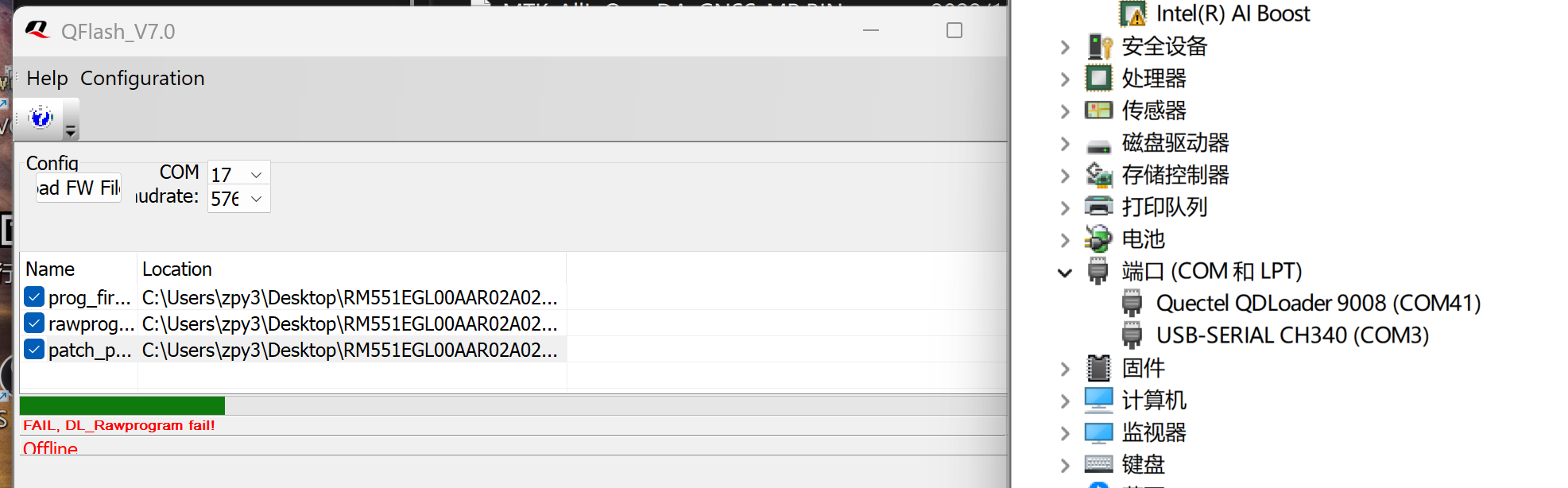

RM551E update failed
My RM551E update failed, please help ,thanks
RM551EGL00AAR01A03M8G->RM551EGL00AAR02A02M8G

Dear @zpy3
It is not recommended to upgrade R01 to R02.
Dear @silvia ,
If I want to upgrade, is there a better way? Can you help me?
@Semsem Thank you, I upgraded successfully
