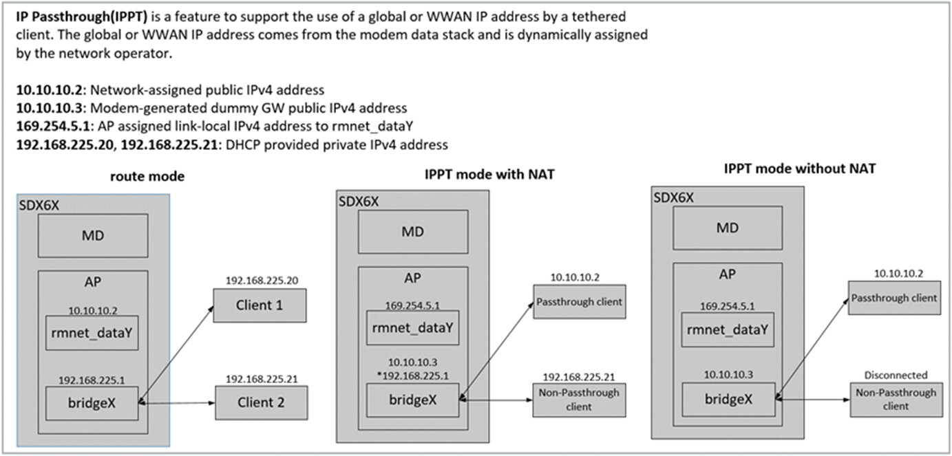

IPPT mode is not enabled.
Please set
AT+QMAPWAC=1
and
AT+qmap="mpdn_rule",0,1,0,4,1,"FF:FF:FF:FF:FF:FF"
It would take effect after reboot.

Please just check
AT+QMAP="mpdn_rule"
Then try
AT+QMAP="mpdn_rule",0,1,0,4,1,"FF:FF:FF:FF:FF:FF"
Make sure the quote is correct.
If it still failed, maybe we can say that it does not support IPPT or not impleteneted.
