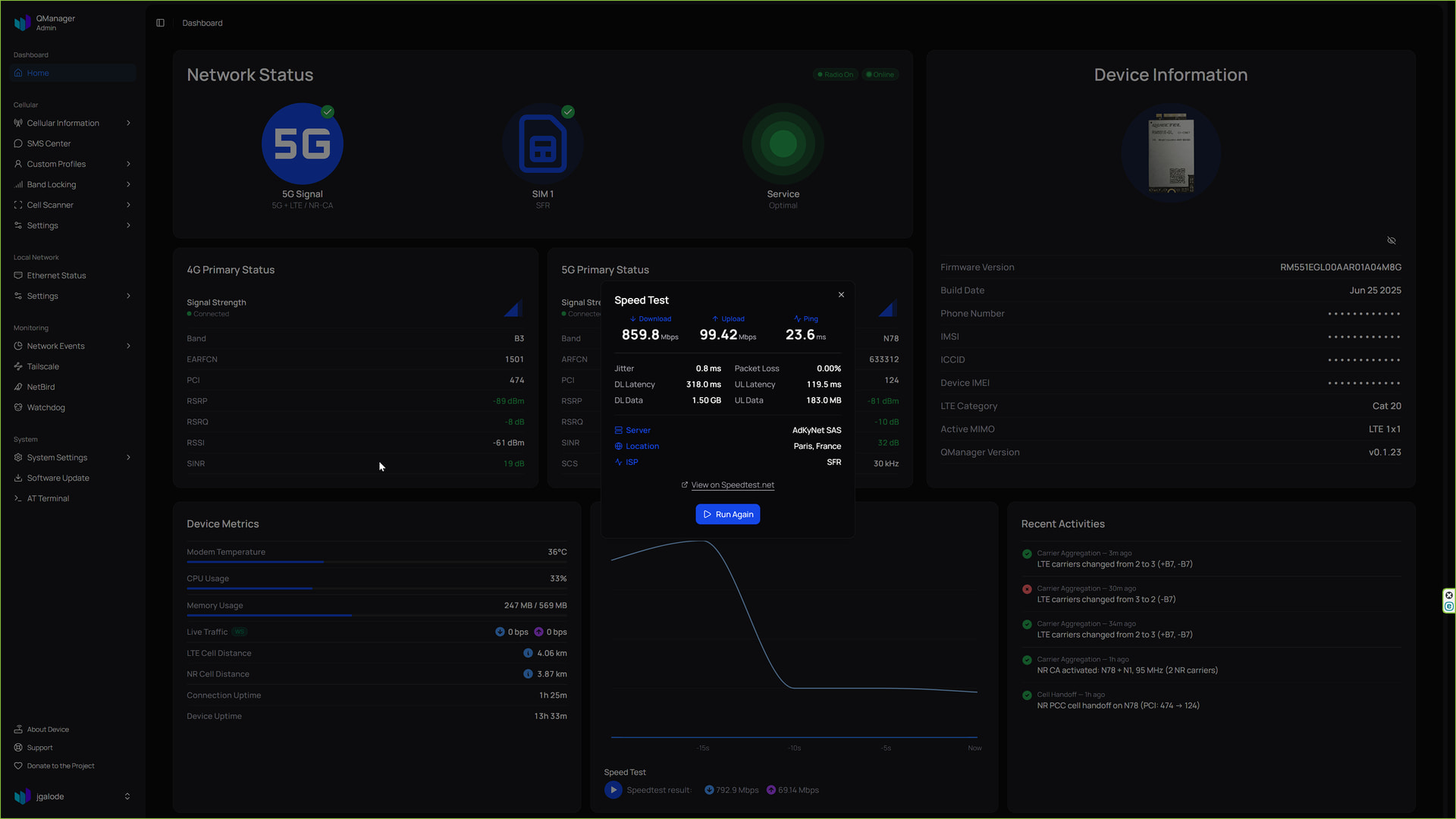

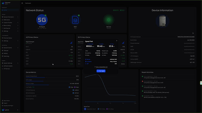

I ended up not finding a solution myself by grabbing a compatible xqcn file from the internet and installing custom iamromulan firmware.
