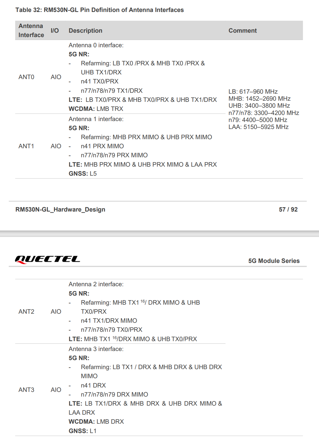

I purchased the Quectel RM530N-GL module and I cannot find any information on the antenna ports. There are 4 MHF4 connections, labeled 0 - 3, but I do not know if any are for MIMO 2x2, MIMO 4x4, or SISO. I have a MIMO 2x2 antenna (not MMWAVE), obviously with 2 connectors, and would like to know to which two ports (of 0, 1, 2, or 3) to connect them? Could tech. support please post the antenna port associations and their band/frequency correlations. Thanks.

Here is the information of antenna interfaces, please check.
Thank you for the information. I do not see n71 or n25 anywhere. Does the RM530N-GL not support those frequencies, or is the n71 lumped in with the ANT0 LB? Not sure where n25 should be connected. I have 2x2 MIMO antenna. Which two ANTx’s should be hooked up for n71 and/or n25 signal acquisition?

It supports n25 and n71.
Do you want to use SA or NSA?
That is not up to me. That is up to T-Mobile, my SIM card provider. I believe T-Mobile is SA nowadays, but I live in the country-side, so it could be that maybe I’m still in an NSA area. If you could please tell me both, especially if there is a difference. Thanks.

I have sent the combinations for reference via Message, please check.
