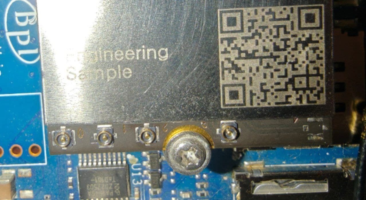

Antenna Ports on modems (visually) are ok

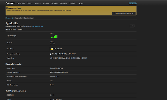

I tried on OpenWRT router and on M.2 adapter 2.5GB
I tried to change the IMEI but also nothing change still I can’t get the NSA 5G bands or 5G Bands at all .also when I scanned nearlly cells

Band : B1    Signal : -36 (dBm) EARFCN : 500  PCI : 36 (current)
Band : B3    Signal : -34 (dBm) EARFCN : 1450  PCI : 120
Band : B3    Signal : -44 (dBm) EARFCN : 1279  PCI : 120
Band : B40    Signal : -65 (dBm) EARFCN : 38956  PCI : 68
Band : B40    Signal : -64 (dBm) EARFCN : 39154  PCI : 68
Band : B40    Signal : -64 (dBm) EARFCN : 39154  PCI : 179
Done
modem doesn’t detect 5G bands …

Two things came to my mind either the modem defected or antenna ports on the modem defected I’m not sure

  • I tried to change antenna ports but no luck ..

my expectations are the modem 5G chip is damaged or antennas but need something to confirm that .. but as you see the the condition of the modem antenna ports are very good ..

Dear @Majid_Alzahrani
Actually, it is hard to check the issue, the module is engineer sample, we are not sure whether hardware has problem.
So let me understand something ..
simply
The modem has 2 sections one for 5g and one for 4g as hardware ? is that right ?
Which antenna ports are linked to 5G ? and which one linked to 4G ?
Please check antenna interface as below:
