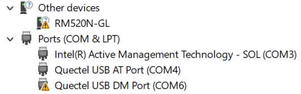

I previously has installed on my Windows 11 laptop the drivers for RM520N-GL working fine. I had to uninstall them due to some conflict with the drivers for RM500U. Once finished the activity with RM500U I uninstall the related drivers and tried to install the ones for RM520N-GL. No way now I can get the modem properly recognized. This is my actual status:

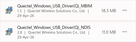

Here the drivers I am installing:
Also, even if the Quectel USB AT Port (COM4) “looks” fine, I am not able to connect via serial connection the modem.
Anyone else faced this issue? Any suggestion?
Thanks in advantage for your support.
As I guess the RM520N is boot in RNDIS mode,
You can try remove all the Quectel driver and just install the RNDIS(Q) driver.
If it still not work, we need a Linux PC.
