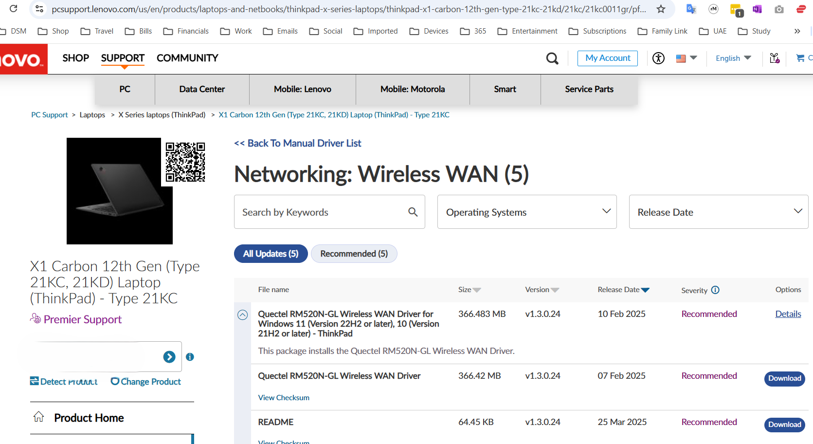

I already downloaded from the Lenovo site. please see attached. but as i highlighted it’s not working. Is there any harm if I try to install the default firmware from you? If it works, it would be great. If it didn’t work, then I’m back to square to one. please advise. thank you

I think it is. But this firmware is customized by Lenovo. I am not sure if it is the latest Firmware.
In addition, we need pay attention to such a fact you mentioned. This module is installed to other PC. It can be detected. But it cannot be detected on your X1. Generally, the device should be detected even there is no any driver is installed. So I’d recommend you to check with Lenovo why X1 cannot detect it.

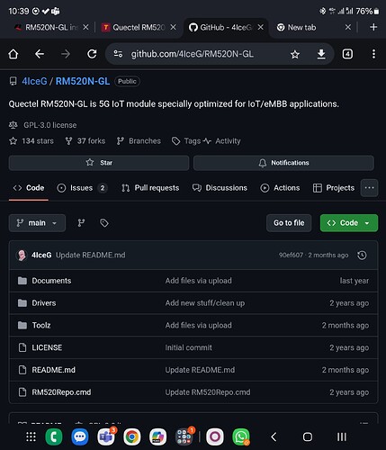

I found this link instead on Github. GitHub - 4IceG/RM520N-GL: Quectel RM520N-GL is 5G IoT module specially optimized for IoT/eMBB applications.
is this safe to download?
Instead of searching for the correct driver from other websites, can you please send it to me?

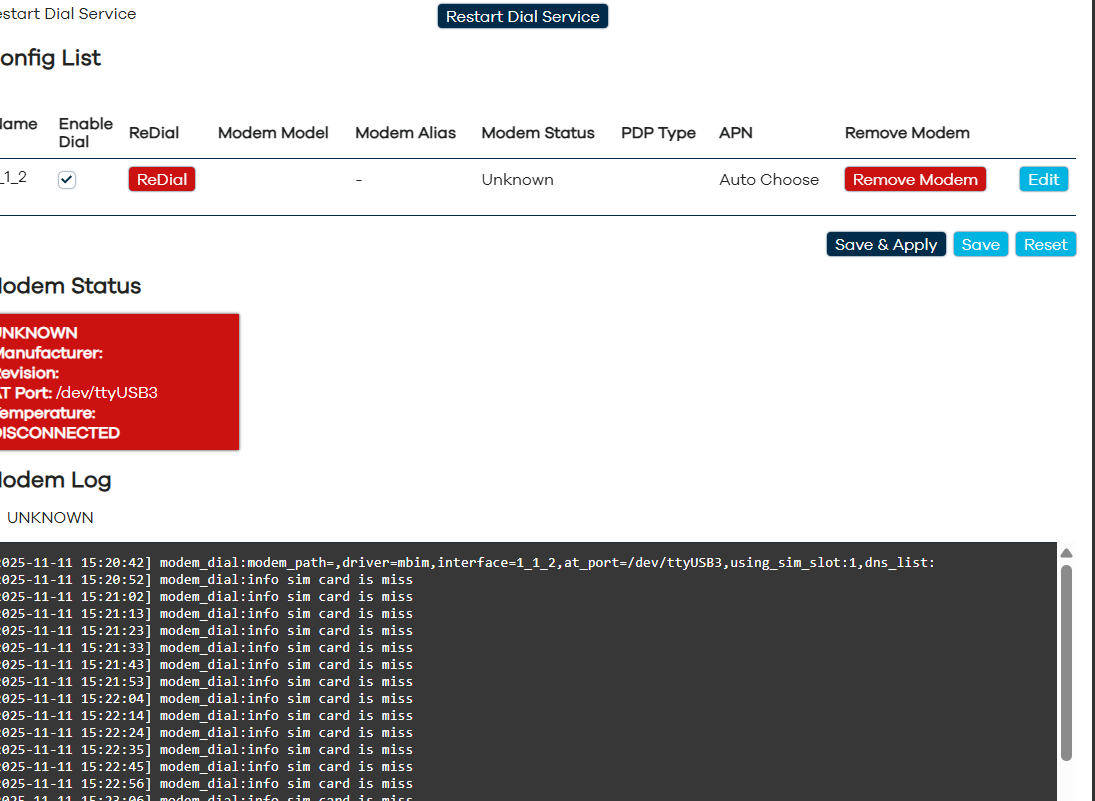

Hi, could you tell me if you managed to get this card working? I have the same modem and the same problem. It’s not showing up anywhere. I tried Linux in OpenWRT and the problem is still there. OpenWRT shows it as a USB modem but there’s a problem with the card.
Dear @arni
Please confirm whether the hardware of SIM card is fine.
Dear @arni
It is inserted in Lenovo PC and firmware is customized, please contact with Lenovo.
