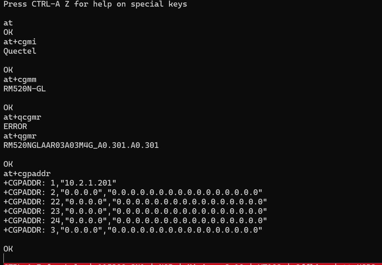

RM520N-GL: How to disable NAT / enable IP Passthrough via AT commands?
I want to disable NAT on the modem so the host device (Raspberry Pi) receives the public/routable IP address directly from the 5G core network instead of a private NATted IP

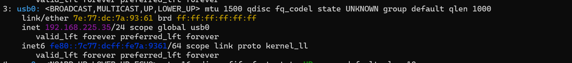

Please query AT+QCFG=“usbnet” .
