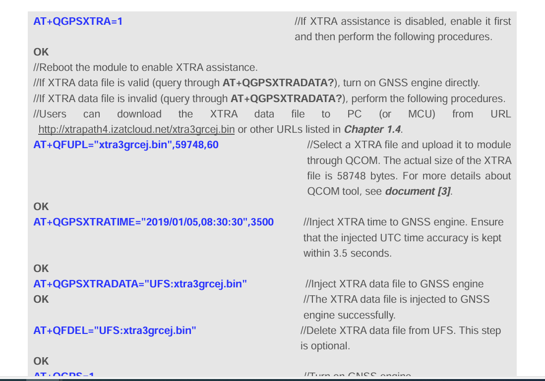

Dear @kivanov
Do you configure lie below?
Hello, I was able to execute it , but I always get +QGPSXTRADATA: 0,“1980/01/06,00:00:00”
The other issue is that I can’t update file regulary.

So I tried to run GPS in MSB mode: with AT+QGPS=2,30,2 should I change anything? Should I execute Operation Procedures of AGNSS? Should it work with default data? I’m located in Sofia, Bulgaria, EU. 5G Provider is A1, what is the proper setting so it always work?
Dear @kivanov
I have sent the document to you, please check.
